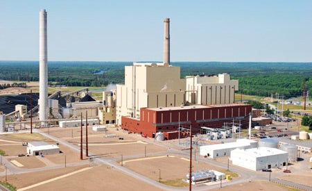

Weston 4 is among the few next-generation supercritical projects expected to enter service in the U.S. this decade (Figure 1). Wisconsin Public Service Corp. (WPSC) selected the supercritical pulverized coal design for all the right reasons: life-cycle economics, the lowest practical emissions, and technology that has proven itself in decades of service. The $750 million Weston 4 will provide reliable and cost-competitive power for the utility’s retail and wholesale market customers for its 40-year design life and beyond.
1. Flagship station.
Wisconsin Public Service Corp.’s 530-MW Weston 4 wins the “clean coal technology” trifecta by using low-sulfur subbituminous Powder River Basin coal, state-of-the-art air quality control systems, and supercritical combustion technology. Weston 4 began commercial operation on June 30, 2008. Courtesy: Wisconsin Public Service Corp.

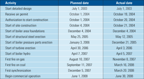

Table 1. Major project milestones for Wisconsin Public Service Corp.’s Weston 4. Source: Wisconsin Public Service Corp.
Weston 4 also participated in the growing industry trend of lengthening planning cycles: Construction began on October 21, 2004, and was followed by a groundbreaking ceremony on November 8, 2004—two years after the first public announcement of the project. Weston 4 was six years in the making (Table 1).
