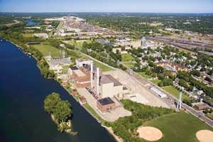

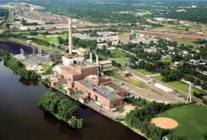

1. Before and after. Xcel repowered its century-old coal-fired Riverside Plant (top) with gas-fired state-of-the-art combustion turbines and heat-recovery steam generators to drastically reduce plant emissions while getting another 80 MW of power generation from the plant. The Unit 7 steam turbine was reused by the repowering project, while the Unit 7 boiler and the entire Unit 8 were retired from service and are in the process of being demolished and removed from the site. The repowered Riverside Plant (bottom) entered commercial service on May 1, 2009. Courtesy: Xcel Energy
