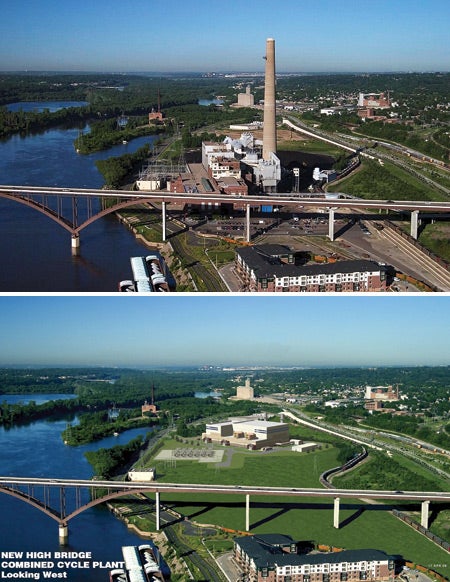

This May, when Xcel Energy’s High Bridge Combined Cycle Project entered commercial service, it marked the end of an era in St. Paul, Minn. The new 570-MW natural gas-fired plant, on the banks of the Mississippi River near downtown St. Paul, replaces the 270-MW coal-fired High Bridge power plant built in 1923. Like the old plant, the new one takes its name from the structure that spans the river nearby (Figure 1).
1. Before and after. Xcel Energy’s new 570-MW gas-fired High Bridge Power Project (top) has replaced the utility’s 270-MW coal-fired plant (bottom), adding 300 MW of capacity and substantially reducing the site’s air pollution and CO2 emissions in the bargain. The view is to the west. Courtesy: CH2M HILL
