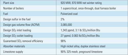

TVA elected to package the complete Bull Run project scope — engineer, procure, construct (EPC) — including balance-of-plant and original equipment manufacturer FGD technology, into one contract. TVA engineers developed the conceptual design and defined the entire project scope of work and emissions guarantees, including a very aggressive 98% sulfur removal efficiency (see table). Advatech — a URS/Mitsubishi Heavy Industries America joint venture — was selected as the EPC contractor in a multiple scrubber system purchase by TVA. The FGD technology was supplied by Mitsubishi Heavy Industries.
Bull Run Fossil Plant FGD Project specifications. Source: URS Washington Division
