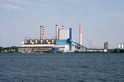

Larson pointed out that the Patnów II plant was the first of a series of planned projects to demonstrate leading-edge technology for coal-fired power plants, which still generate over 94% of the power in Poland. Patnów II is the largest new project recently completed and is both highly efficient and less polluting than any other project currently operating in the Polish market: It meets emissions requirements of both the EU and the Kyoto Protocol (Figure 1).
1. Polish pride. The Patnów II Power Plant represents a new era in electricity generation for Poland. The plant will sell a portion of its power to the Polish grid company, PSE. Courtesy: SNC-Lavalin Constructors Inc.

When SNC-Lavalin arrived on Patnow scene the new plant was fully designed and majority of its main elements had been earlier constructed waiting for the final assembly. This type of company like SNC-Lavalin was necessary to persuade bankers to unfreeze their loans for manufacturers’ remunerations and finally end up of the project. This plant was completely designed by Energoprojekt Warszawa, similarly as a new 858 MW power generation unit in Belchatow equipped with pulverized lignite boiler no circulating fluidized bed boiler as it states in the article. Saying the SNC-Lavalin came to switch on the lights only would be no truth as well as not appreciating the plant’s engineering.
While designing it was the second of this type and size plant in the world following an example of just finished Schkopau Plant in Germany, however with different types of steam turbines and cooling system. From early beginning the plant was designed to keep pace with the newest European environmental standards and achieve the highest possible efficiency based on reasonable selected steam parameters. Presenting the current state-of-the-art it aimed to be the best lignite fired power plant in the world for this size of generation units. I am proud to be a leader of engineering team but minimum a one name should be also mentioned – Mr Zbigniew Radomski.
In really Soviet block in Poland before 89’ the power plants in Poland are not “based mostly on Soviet-designed power plants” as Mr. Larson said. Really, any of these plants follows the Soviet designs as it occurred to be in East Germany. They were completely engineered by Polish designers and were patterned on the best West European examples so they are similarly efficient and polluting as those plants from 70’s. They were not “supplemented by British-designed mid-sized steam turbine technology” but essentially equipped with Swiss’ Brovn Boveri engineered steam turbines and steam boilers of German’s EVT engineering. It was a previous generation of plants designers but it would be graceful to notice that they did not adopt the Soviet designs.

The cover story for the March 2009 Power Magazine, referenced in the subject line, appears to have some errors. Perhaps these errors have already been addressed.
First, the description of Patnow II, on page 1, states that it is a supercritical CFB unit. Based on my research, it appears that this is not correct and that it is a supercritical PC unit. The article correctly states that the unit at Lagisza is a 460 MWe nominal supercritical CFB unit.
In the main article there are references to Figures 1, 2 and 3. These figures do not appear to be included in the article. If these references are refering to the photos, labeled 1, 2 and 3, then the photo content does not appear to relate to the paragraph text.
On page 30 there is a reference to the 858 MW CFB unit at Belchatow. Again based on my research, this appears to be a PC unit not a CFB unit.
Especially since this was a cover story, I thought Power might be interested in in investigating these apparent errors and, if you verify the errors noted, possibly printing a corrected article or at least advise your readers of your findings.
