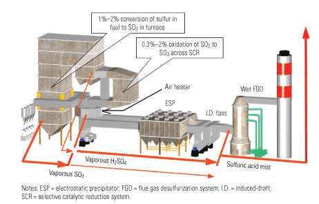

Although the attention that SO3 has received has been focused on its visible emissions, the presence of SO3 also creates some serious operations and maintenance problems for back-end plant equipment, as detailed in Part I of this series. The effective removal of SO3 can eliminate those problems, producing some very valuable benefits for power producers.
The benefits of SO3 reduction
Although the O&M benefits achievable are a function of where and to what extent the removal occurs, for the purposes of this article, "effective SO3 removal" is defined as reducing its concentration to 3 ppm or less at the entrance to the air heater. (Figure 1 shows where SO3 is created and the forms it takes.) If this can be accomplished, the potential savings are considerable. Bear in mind that the examples presented here are merely illustrative; site-specific economic assessments would be required to provide quantifiable benefits for a particular plant.
1. Acid reign. Where SO3 is created and the forms it takes. Source: Codan Development LLC

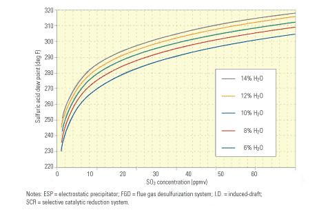

Reduced acid dew point and back-end corrosion. Limiting the level of SO3 at the entrance to the air heater to 3 ppm or less substantially reduces the sulfuric acid dew point. Figure 2 illustrates the relationship between the two variables. Note that at 60 ppm SO3—a concentration not unusual when burning a high-sulfur coal with a selective catalytic reduction (SCR) system in service—the acid dew point is about 310F. Also note that at 30 ppm SO3—a concentration typical when burning a high-sulfur coal without an SCR system in service or using an SCR system with a very low oxidation catalyst, or firing a medium-sulfur coal with an SCR system—the acid dew point is roughly 295F. At 3 ppm SO3, the acid dew point is about 255F.
2. Dew diligence. The lower the SO3 concentration at the air heater inlet, the lower the sulfuric acid dew point and the lower the potential for corrosion of back-end equipment. With the unit operating at an excess air level of 8%, at SO3 concentrations of 60 ppm, 30 ppm, and 3 ppm, the corresponding dew points are 310F, 295F, and 255F, respectively. Source: F.H. Verhoff and J.T. Banchero, Chemical Engineering Progress, Vol. 70 (1977), p. 71
Because the SO3 gas will not condense until cooled to its dew point, the potential for corrosion can be reduced considerably by capping the concentration of SO3 at the air heater inlet at 3 ppm. And if it can be reduced to 3 ppm or less there, the SO3 level will almost certainly be reduced further as the gas is adsorbed on flyash in the air heater and on ductwork to the electrostatic precipitator (ESP). All told, corrosion of all back-end components will be greatly reduced.

It's important to note that the shape of the dew point curves in Figure 2 bears heavily on the potential heat rate and cost benefits of SO3 reduction shown in Figure 3. Reductions in acid dew point (and, thus, heat rate) driven by reductions in SO3 concentration are significant only at very low levels. For example, the change in acid dew point between 60 and 30 ppm SO3 is about 15 degrees F—less than the 20 degrees F change in dew point produced by reducing SO3 from 10 ppm to 3 ppm. Accordingly, the heat rate/fuel saving benefits achievable are not very different for the 30- and 60-ppm cases, regardless of removal efficiency.
The amount of SO3 removed (and, presumably, the amount and cost of reagent required to do so) for a unit operating at a 30-ppm level would be one-half that for one running at 60 ppm SO3. The lower the concentration of SO3 in the target stream, the greater the savings potential. In other words, for units burning low-sulfur coal, savings are easier to come by. For example, removing 95% of the SO3 from a 10-ppm flue gas stream would suppress dew point by 40 degrees F (from 275F to 235F); at the same removal rate on a 60-ppm stream, the dew point would fall by 55 degrees F (from 310F to 255F). That means that 73% of the fuel savings of the 60-ppm case could be realized in the 10-ppm case with about 16% of the SO3 removal reagent cost.
