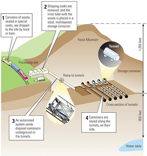

Thirty years after the U.S. government began assessing if a remote ridge in the Mojave Desert 90 miles northwest of Las Vegas, Nev., was suitable for the nation’s first permanent deep geologic nuclear waste repository, the Department of Energy (DOE) has formally filed an application with the Nuclear Regulatory Commission (NRC) for a license to proceed with construction.
The 17-volume, 8,600-page application that the NRC received by truck on June 3 details the DOE’s plan to safely isolate spent nuclear fuel and high-level radioactive waste in tunnels deep underground at Yucca Mountain. The submission marks an apex in the Yucca Mountain saga: For the first time since Congress enacted the Nuclear Waste Policy Act (NWPA) in 1982, the focus will shift away from the DOE and to the NRC.
Now, the NRC must review the DOE’s plan and decide whether the repository can safely contain 77,000 tons of high-level waste, including 57,000 tons of commercial spent fuel that is being currently stored at 121 temporary locations in 39 states across the nation (Figure 1).
1. Moving closer to construction. The DOE filed a formal application with the NRC for a license to begin construction of a high-level nuclear waste repository deep within Yucca Mountain in Nevada. The application defines how the facility can safely store the waste for at least 10,000 years. Source: DOE
