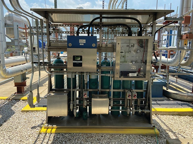

Today’s leading CEMS solutions replace conventional complexity with a single integrated advanced laser spectroscopy platform (Figure 1). This modern approach provides better accuracy, greater reliability, and lower costs of ongoing ownership, particularly in the natural gas and emerging power sectors. These solutions feature both quantum cascade laser (QCL) and tunable diode laser (TDL) technologies working in tandem, enabling detection of a multitude of gases.
Emerson-Rosemount-Gas-Analyzer-CEMS-continuous-emissions-monitoring-system
1. Emerson’s Rosemount CT5100 Continuous Gas Analyzer CEMS (continuous emissions monitoring system) solution provides real-time tracking, analysis, and reporting of pollutant emissions, helping users ensure compliance with environmental regulations. Courtesy: Emerson

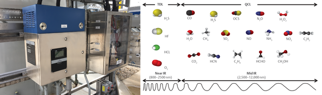

Different gases absorb light at specific frequencies, creating a unique spectral fingerprint. TDLs operate in the near-infrared (IR) spectrum, which is ideal for measuring certain molecules, while QCLs operate in the mid-IR range. The mid-IR spectrum is particularly valuable for emissions monitoring because molecules exhibit their strongest and most fundamental vibrations in this zone, creating absorption peaks that are sharper and more intense. This facilitates high-accuracy and interference-free measurement of a wide range of gases, even in complex mixtures.
By combining QCL and TDL technologies in a single analyzer, this type of modern system can simultaneously measure the most critical components in typical flue gas streams—NOx (direct measurements of both nitric oxide [NO] and nitrogen dioxide [NO2] independently), CO, O2, CO2, methane (CH4), NH3, and SO2—without the need for separate analyzers or outdated conversion equipment. This multi-component analysis is performed using a hot/wet extractive method, in which the sample is maintained at a high temperature from the probe to the analyzer (Figure 2).
hybrid-quantum-cascade-laser-QCL-tunable-diode-laser-TDL-analyzer
2. A hybrid quantum cascade laser (QCL)/tunable diode laser (TDL) analyzer, such as Emerson’s Rosemount CT5100 Continuous Gas Analyzer, can be configured with up to six laser modules, some of which can measure two analytes. Each laser type covers its respective pollutants. Courtesy: Emerson
By keeping the flue gas above its dew point, this approach eliminates the need for chillers and pumps to remove moisture, while also preserving the sample integrity, and providing a more accurate and timely measurement of the actual stack gas composition. This is especially critical when measuring soluble gases like NH3, which would otherwise be lost in the condensed water of a conventional cold/dry system.

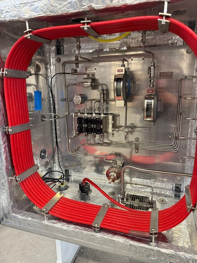

sample-handling-conditioning-system
4. A close-up view of the sample handling conditioning system within Emerson’s CEMS Engineered Solution. Courtesy: Emerson
Emerson’s Rosemount CT5100 Continuous Gas Analyzers were the key components in the CEMS engineered solution selected for this critical energy infrastructure project. These analyzers combine QCL and TDL technologies in a single unit, providing measurement breadth that was previously unattainable using a single device. The hot/wet sampling system operates at more than 200C, eliminating issues with chiller failures or plugged sample lines. The system provides 10 to 15 years of operation with little to no drift, drastically reducing the need for frequent calibrations. A fast update rate of one second provides operators with real-time process insights, enabling tighter control of combustion and emissions abatement systems.
