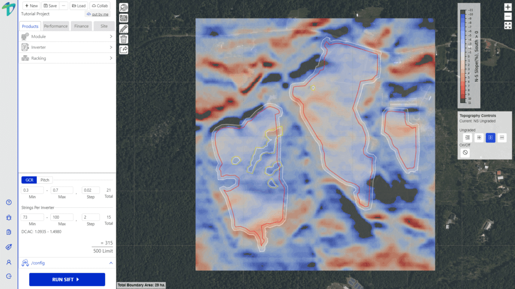

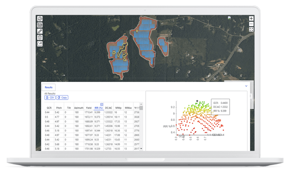

Solution: Using its site feasibility software, the IPP’s racking vendor modeled a variety of GCRs—ranging from 30% to 60%—against different types of racking systems to reach the project’s 9 MWdc target. In under 60 seconds, the software generated 21 proposed layouts, comparing a fixed tilt rack to a slope-tolerant tracker system.
Because of the tool’s speed, the IPP could be part of the design iteration process in real time. Using topographic data from USGS, the software was able to quickly provide slope analyses for each racking option to deliver a more realistic design. As the design meeting concluded, the IPP had several realistic layouts to consider; the software extracted a CAD of the final layout to hand off to the racking company’s design team so that they could provide a quick turnaround on pricing for the racking system.
Project feasibility software should enable project developers to gain confidence in early-stage decisions, improve project returns, and speed up the development cycle. Source: Terrasmart
Results: The experience allowed the IPP to scope realistic design options to meet its system needs. Because the final design used a slope-tolerant tracker, it offered the cost advantages of reduced grading and civil works to manage the hilly terrain.
