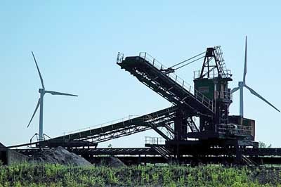

The Steel Winds project in Lackawanna, New York, was selected as a POWER 2007 Top Plant because of its unusual location (a former steel mill and Superfund site) and because it was the first commercial deployment of the Clipper Windpower 2.5-MW turbine. That report was written just as the project entered commercial service but before a major gearbox problem was identified. For many new designs, it isn’t a question of if problems will occur but of how the manufacturer responds when problems inevitably do occur. For its handling of Liberty’s problem, Clipper Windpower gets an "A."

1. Rust Belt goes green. The Steel Winds Project, the first commercial deployment of theClipper Windpower 2.5-MW turbine, is located on the site of a former Bethlehem Steel mill and Superfund site along Lake Erie in Lackawanna, south of Buffalo. The 1,600-acre site is under redevelopment for public use. Courtesy: Clipper Windpower
Erected on a former Bethlehem Steel industrial site, the eight 2.5-MW Clipper Liberty wind turbines are owned by First Wind (formerly known as UPC Wind), a company that operates 92 MW of energy capacity through three wind farms.
