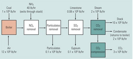

The high cost of gas compression and storage dictates that CO2 be separated from other flue gases prior to sequestration. Postcombustion capture poses two significant design challenges: the relatively low partial pressure of the carbon dioxide in the flue gas and the relatively high temperature of the flue gases.
Figure 1 is a schematic/mass-balance representation of a typical 1,000-MW coal-fired power plant whose CO2 capture equipment is installed downstream of systems for reducing emissions of NOx, particulates, and SO2. Note the supply of low-pressure steam to the "CO2 removal" box at upper right; it would not be required if the removal vehicle were gas separation membranes rather than a chemical absorber. The steam would normally be extracted from the steam cycle, decreasing the net plant output. After compression, the CO2 stream exiting bottom right of the figure would be available for sequestration.
1. Retrofit potential. Mass balance for a typical 1,000-MW (existing) power plant with postcombustion CO2 capture. Source: MPR Associates
The mass-balance numbers shown in Figure 1 illustrate the following:
  • The CO2 emission rate is four times that of the coal flow.
  • The concentration of CO2 may be low, but the quantities of CO2 are very large relative to other streams in the power plant.
  • The CO2 concentrations are low because the air flow is an order of magnitude greater than coal flow.

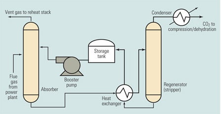

Chemical absorption. Existing commercial applications of chemical absorption—the most widely used method of commercial CO2 capture for more than 60 years—include enhancing oil recovery by injecting CO2 into oil wells.
Figure 2 is a simplified schematic/flow diagram of the process. The flue gas stream enters at the left side of the figure. The chemical solvent and CO2 are exposed to each other in the absorber, where they chemically react to form a loosely bonded intermediate compound. This compound, in liquid form, is then isolated by transferring it to the regenerator (stripper), where heating causes its breakdown into separate streams of CO2 and solvent. The CO2 is then condensed and dehydrated and compressed before being stored for commercial use or sequestration.
2. Can it be scaled up? Simplified chemical absorption process diagram. Source H. Herzog, "An Introduction to CO2 Separation and Capture Technologies" (MIT Energy Laboratory, 1999)
The stream of solvent—typically, monoethanolamine (MEA)—produced in the regenerator is recycled back to the absorber, enabling the process to be repeated. The storage tank in the solvent return line allows for constant CO2 removal despite variations in solvent recycling rates. The booster pump in the same line provides the pressure gradient required to transport the solvent. The heat exchanger transfers heat from the relatively hot fluid returning from the regenerator to the relatively cool fluid flowing to the regenerator.
The chemical absorption process uses pressure vessels, storage tanks, pumps, and heat exchangers similar to those of many other industrial processes. The absorber module is a gas/liquid contactor located within a carbon steel vessel or duct. This component is similar to the wet scrubber modules that have been retrofitted onto many coal-fired power plants. During operation, the absorber module pressure and temperature are approximately equal to those of the exhaust entering the module. Unlike a wet scrubber, the absorber module generates no significant waste product.
Chemical absorption has two big advantages: It produces a relatively pure carbon dioxide stream, and its technology is mature and commercially available today. However, the process has two equally big disadvantages: It imposes an "energy penalty" of 25% to 37% on power plants burning coal, and the large size of the required components not only makes the equipment expensive, but it also increases the footprint of the host plant by about 60%.
Following are some potential issues that could affect the cost of implementing chemical absorption systems:
  • Existing chemical absorption equipment and processes would have to be scaled up for application to utility power generation.
  • The SO2 and oxygen contained in flue gas will degrade amine solutions. An effective way to counter these mechanisms in large-scale installations that do not have effective SO2 scrubbers will have to be developed.
  • Reliable operation of packed towers used in chemical absorption systems needs to be demonstrated.
