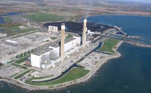

The Nanticoke Generating Station (Figure 1) is equipped with eight units, each with a nominal rating of 500 MW. The boilers are of the opposed-fired configuration, originally designed to fire a mid-sulfur bituminous coal. Currently, the Nanticoke boilers fire a furnace blend of 80% (by energy) Powder River Basin subbituminous coal with 20% low-sulfur eastern bituminous coal (see table). The units are equipped with five 10E10 ball-race pulverizers. All five mills are required for full load.
1. Leading the way. The Nanticoke Generating Station is located on the north shore of Lake Erie. Both it and its sister facility, the Atikokan Generating Station, are pioneering the use of biomass as a renewable energy source for their operations. Courtesy: Ontario Power Generation

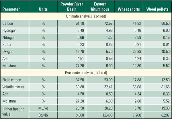

A comparison of cofired fuels. Source: Ontario Power Generation

The initial test program provided the first results to OPG regarding the impact of biomass use on the firing systems and acid gas emissions. However, due to the nature of the truck unloading method (compartmentalized biomass, gravity fed to an onboard blower), it was difficult to control the biomass injection rate and avoid line pluggage. In addition, this mode of operation was limited in both capacity and duration. The need for a larger, engineered system was recognized in order to better demonstrate the potential of biomass at Nanticoke.
