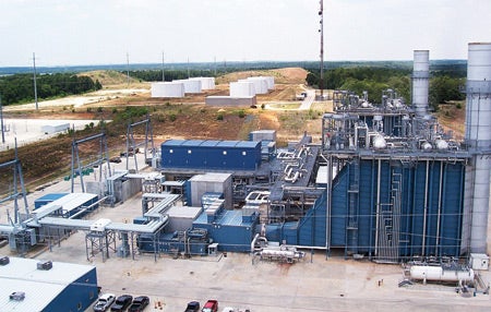

Lower Colorado River Authority (LCRA) began operating the first 150-MW unit of the Sim Gideon Power Plant (see cover photo) in 1965. Another 150-MW unit was commissioned in 1968, and a third, rated at 350 MW, went commercial in 1972. The old plant shares its site with the Lost Pines 1 Power Project, a gas-fired combined-cycle plant that came on-line in May 2001 (Figure 1). At the time, Lost Pines was owned by GenTex Power Corp., a nonprofit subsidiary of LCRA. In 2006, when the facility became wholly owned by LCRA, it was renamed the Lost Pines Power Park and the staffs of both plants were combined.
1. Shared site and staff. The Lost Pines Power Park includes the three gas-fired steam units of the Sim Gideon Power Plant (shown on the cover) and the six-year-old Lost Pines Power Project combined-cycle plant shown here. A single plant staff operates both facilities. Courtesy: LCRA
