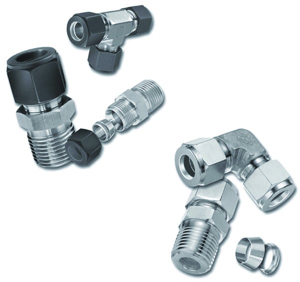

The single- and double-ferrule fittings have both had a presence in the industry for more than 50 years. However, due to various reasons that are mostly associated with specific market penetration and patent issues, the double-ferrule design has been the one that most dominated the power plant instrumentation industry (Figure 1). However, one cannot definitely say that this design was the one that most plant operators independently desired. The design itself has some issues that the single-ferrule fitting doesn’t share. For example, there is a big difference in the assembly.
1. Parker CPI/A-LOK instrumentation tube fittings are designed as leak-free connections for process, power, and instrumentation applications. These single- and two-ferrule fittings are available in a broad range of sizes and configurations. Courtesy: Parker Hannifin
One element that would cause a plant operator to lean toward a double-ferrule design as opposed to a single is its assembly reliability. Basic logic would dictate that when a product is more complicated to assemble, the chance is greater that it will be done incorrectly. Most of this complication comes from the fact that there are so many ways to achieve this incorrect assembly. In fact, there are 14 different ways that a double-ferrule instrumentation fitting can be assembled the wrong way. On the other hand, there are merely two possible ways to incorrectly assemble a single-ferrule instrumentation fitting. Of course, when a fitting is assembled incorrectly and placed in service, there are various safety concerns that will arise.
