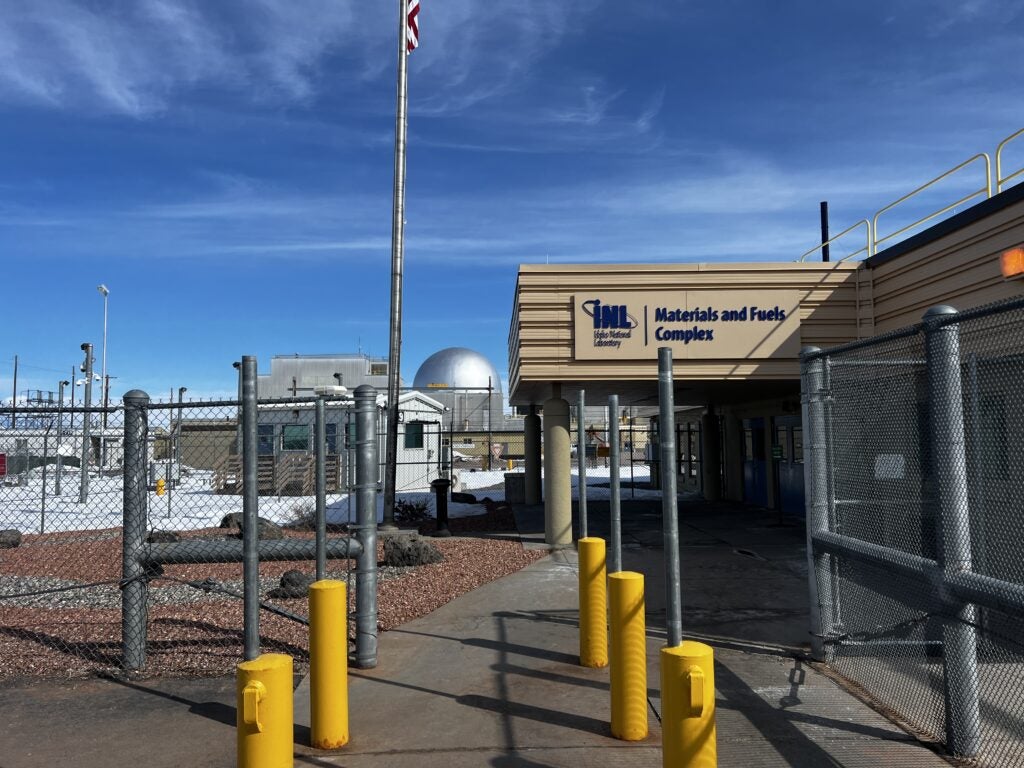

1. The Transient Reactor Test (TREAT) facility provides a transformational research platform that links science and engineering capabilities for the advancement of fundamental science and nuclear technology. Source: POWER
