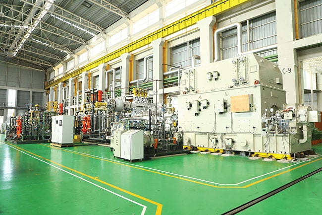

1. Steam turbine assembly and testing facility at Triveni Turbine’s state-of-the-art manufacturing plant. Courtesy: Triveni Turbine Ltd.
Consequently, the industry is placing greater emphasis on validating the complete rotating train before installation (Figure 1). International standards such as American Petroleum Institute (API) 612 require rigorous evaluation of vibration behavior, mechanical integrity, and rotor dynamics for special-purpose steam turbines used in petroleum, petrochemical, and gas industry services. For projects executed against customer specifications, demonstrating compliance also means providing confidence that the complete machine train has been engineered and validated for dependable field operation.
It was against this backdrop that Triveni Turbine Limited undertook the design, manufacture, and shop testing of a 60-MW backpressure steam turbine generator package for a major Middle East oil and gas project. While the turbine rating itself represented a significant engineering undertaking, what distinguished the project was the decision to perform complete train validation within the factory. Instead of testing individual equipment separately, the validation program integrated the steam turbine, gearbox, generator, and dynamometer, enabling engineers to evaluate the behavior of the complete rotating system under conditions closely resembling those expected after site installation. This approach significantly reduced project risk while enhancing customer confidence well before commissioning commenced.
