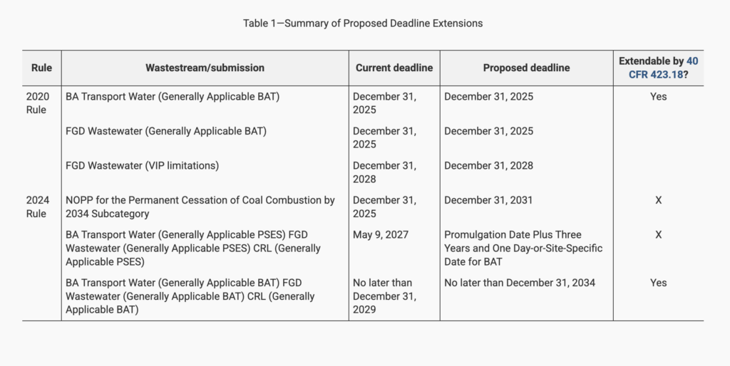

The EPA’s proposed “Effluent Limitations Guidelines and Standards for the Steam Electric Power Generating Point Source Category—Deadline Extensions,” published in the Federal Register on Oct. 2,  extends seven compliance deadlines from the EPA’s April 2024 Steam Electric Power Generating ELG revisions.
The 2024 supplemental steam electric rule, which the Biden administration finalized in  April 2024 as part of a four-rule environmental regulatory package, established zero-discharge effluent limitations for all pollutants in FGD wastewater and bottom ash transport water, along with numeric discharge limitations for mercury and arsenic in combustion residual leachate. The rule marked EPA’s most stringent wastewater discharge standards for coal-fired power plants to date, reversing Trump-era rollbacks and going beyond the Obama administration’s 2015 effluent guidelines by requiring zero discharge for FGD wastewater—a waste stream the earlier rule had not addressed as stringently.
Under the new proposal, specifically, the agency would extend by six years—through Dec. 31, 2031—the deadline to file a Notice of Planned Participation (NOPP) for the “permanent cessation of coal combustion” subcategory. A NOPP indicates a steam electric unit’s intent to permanently cease coal combustion by a specific date, and once filed and approved, the unit is exempt from zero-discharge requirements provided it follows annual progress reporting and completes retirement by the announced cessation date. However, the proposed rule would also move the zero-discharge deadlines for FGD wastewater, bottom ash transport water, and coal combustion residual leachate (CRL) to Dec. 31, 2034. In addition, it seeks to align the pretreatment (PSES) timelines for indirect dischargers (plants that send wastewater to a municipal treatment plant) so those three zero-discharge dates match the direct-discharger schedule in 2034.
The EPA says the changes are meant to “support affordable implementation of advanced treatment technologies,” while keeping the 2024 discharge limits intact. The proposal, notably, does not reopen the 2024 Best Available Technology (BAT) determinations or the zero-discharge limits. Essentially, it seeks to adjust timing and mechanics by updating the transfer provisions so facilities can switch between compliance alternatives.
INSERT ART. Proposed Deadline Extensions for Steam Electric Power Generating ELGs (EPA, Oct. 2 2025) Source: U.S. Environmental Protection Agency, “Effluent Limitations Guidelines and Standards for the Steam Electric Power Generating Point Source Category—Deadline Extensions,” 90 FR 47693 (Oct. 2 2025).
The EPA also published a companion direct final rule, a procedural mechanism that allows the agency to expedite adoption if no significant adverse comments are received. Under this approach, the direct final rule would automatically take effect 60 days after publication—unless the EPA withdraws it in response to public objections—while the proposed rule provides the fallback pathway for a traditional rulemaking if comments are filed. According to the agency, the dual filing will serve “to promptly provide regulatory certainty to affected facilities” and maintain alignment between wastewater compliance schedules and the next NPDES permit cycle.
