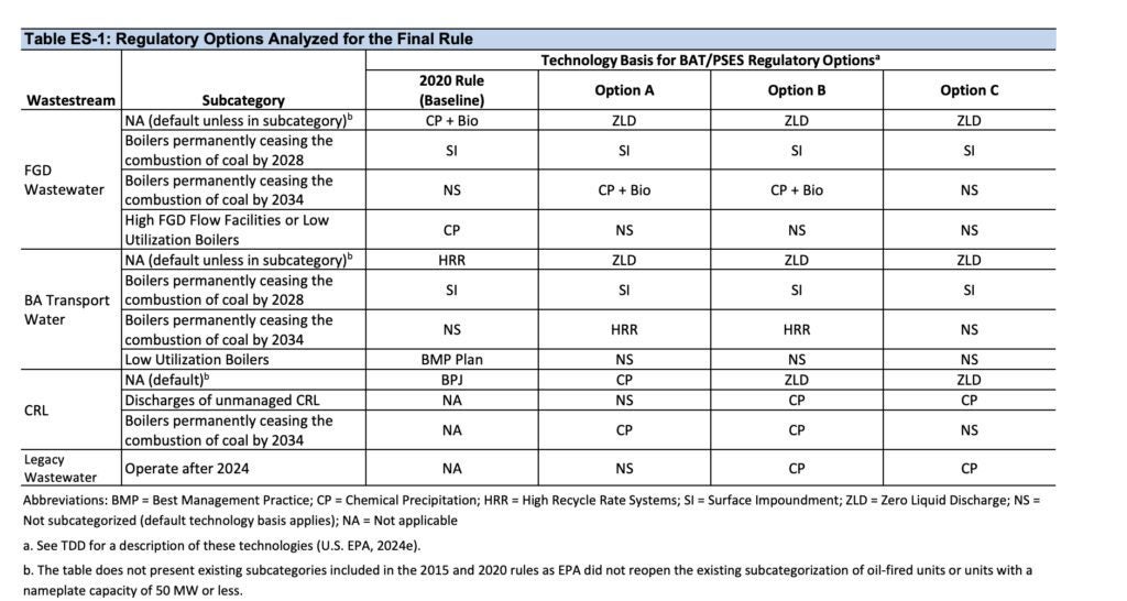

For the final rule, EPA evaluated three regulatory options as summarized in Table ES-1. The agency established best available technology (BAT) effluent limitations and pretreatment standards based on the technologies described in Option B. For more about these technologies, see the EPA’s newly released Technical Development Document. Source: EPA
