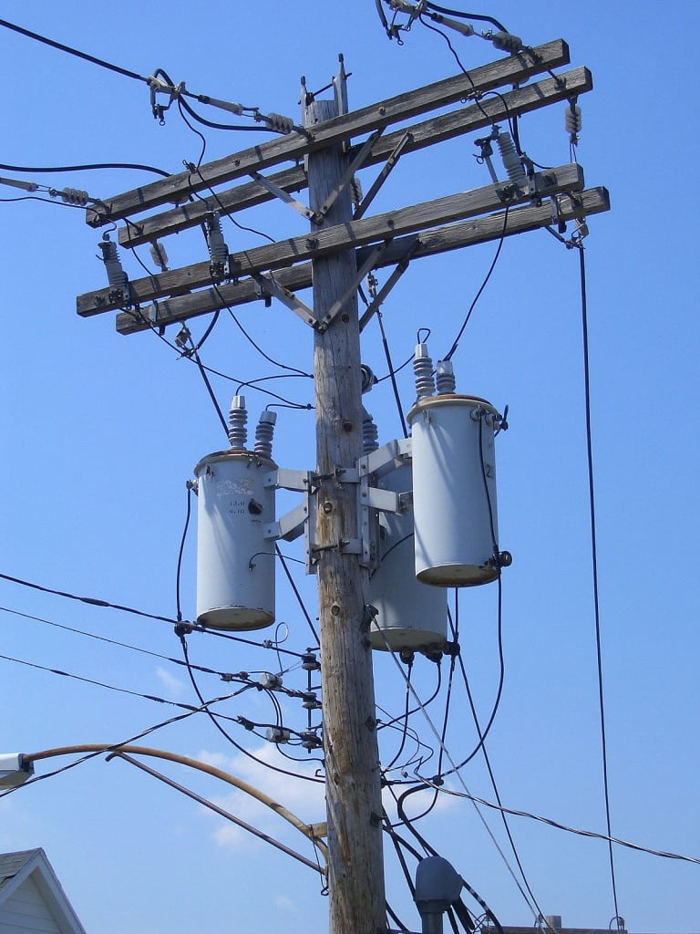

At issue is the impact of the DOE’s January 2023 proposed rule, which seeks to reduce losses in three types of distribution transformers—liquid-immersed, low-voltage dry-type (LVDT), and medium-voltage dry-type (MVDT) distribution transformers—through specific percentage-based energy efficiency standards. The rule could take effect starting three years after it is finalized, which is expected this year.
Compared to power transformers, typically used in transmission networks of higher voltages and for step-up and step-down applications and are generally rated above 200 MVA, distribution transformers are used for lower-voltage distribution networks as a means of end-user connectivity. Distribution transformers have input voltages of 34.5 kV or less and output voltages of 600 V or less and have a capacity of 10 kVA to 2500 kVA for liquid-immersed units and 15 kVA to 2500 kVA for dry-type units.
While broader and more stringent than existing distribution transformer energy efficiency standards that were finalized in April 2013 (and which have applied to units manufactured after January 2016), the DOE has said the rule is necessary to ensure distribution transformers, a “critical component” of the U.S. electricity system, would operate “as efficiently and inexpensively as possible.”
The DOE suggests that if finalized, the proposed standards “would reduce U.S. CO2 emissions by 340 million metric tons over the next 30 years—an amount roughly equal to the annual emissions of 90 coal-fired power plants.” More efficient transformers could also “generate over 10 quads of energy savings and approximately $15 billion in savings to the nation from 30 years of shipments,” it has said.
However, the DOE has also acknowledged that achieving the standards and effectively reducing distribution transformer losses will require an overhaul of the makeup of essential distribution transformer components. The proposed standards, notably, would require almost all transformers to feature amorphous steel cores, “which are significantly more energy efficient than those made of traditional, grain-oriented electrical steel [GOES],” the DOE said.
The market for GOES, cold-rolled grain-oriented steel that typically comprises iron-silicon alloys, was in 2020 primarily dominated by large power transformers (LPTs), but the domestic market is extremely restricted. Amorphous metal (AM) transformer cores comprise an alloy of iron that includes boron, silicon, and phosphorous in the form of thin foil. According to the DOE, the resulting product is thinner than GOES, has lower core losses, and reaches magnetic saturation at a lower flux density.
The DOE reasons that AM (which is not widely used in large power transformers) would free up competition for core steel supply. Metglas, the sole U.S. AM manufacturer, has noted it currently has an installed AM capacity to produce 45,000 metric tons and can readily increase capacity to another 75,000 metric tons within 30 months. Howard Industries —the largest producer of distribution transformers in the U.S.—has estimated the new standards would result in a 60% increase in demand for electrical steel or an overall increase in demand of 600 million pounds of AM.
