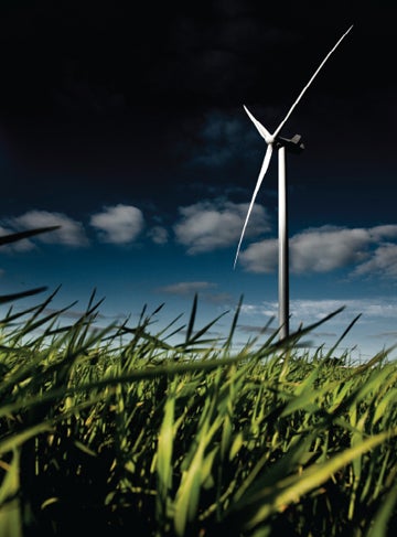

Vestas V112 3.0-MW turbine. Courtesy: Vestas Wind Systems A/S

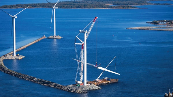

Local wind turbine manufacturers are gearing up to cope with the expanding demand. WinWinD, a Finnish-Indian group based in Helsinki, plans to launch a new-generation 3-MW wind turbine by the end of 2012. One of the country’s largest start-ups, Mervento, should be rolling out its first wind turbine, a product tailored for the needs of the 4- to 5-MW segment, by the end of the same year. “At the moment, our main focus is on Finland,” commented Guru Vijendran, CEO of WinWinD (Figure 1). “The national targets are ambitious and the feed-in tariff scheme has finally been introduced. I cannot see any reason why we should not get a significant share of the Finnish market. We have been in the market for 10 years, our turbines are already up and running out in the field, and our customers are planning to expand.”
1. Rotor installation at Ajos Wind Park in Kem, Finland. Courtesy: WinWinD
