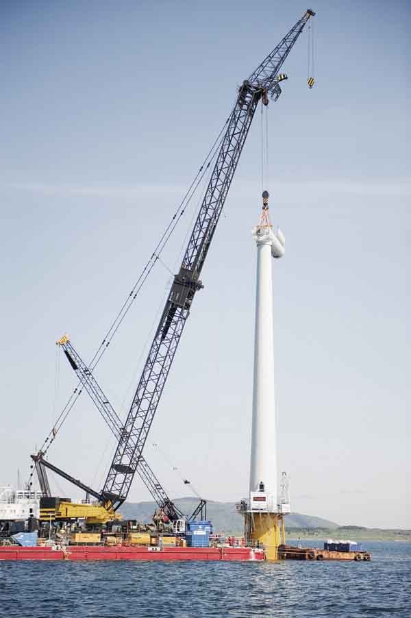

Siemens Wind Power in Denmark manufactured the turbine, while France’s Technip built the floater (see the online version of this article for a photo of this structure before it was submerged), and Nexans produced and laid the power cable to land. Following assembly in the Åmøy Fjord near Stavanger, the Hywind pilot was towed in June to its current location near Karmøy island for the two-year test period (Figure 2). In August it was connected to the local grid and started producing power.
2.    Norse know-how. Erection of the large-scale wind turbine took place in the North Sea near Karmøy, Norway. Courtesy: StatoilHydro
