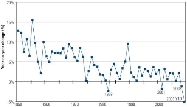

Year 2009 began amid one of the worst economic environments in many decades. U.S. industrial production collapsed, financial markets were in disarray, asset prices shrank, and we witnessed real demand destruction across most sectors of the economy, including the electric power industry. According to Energy Information Administration (EIA) data, total power generation was down 5.4% (the latest figures, year-to-date July 08/July 09), and industrial power consumption was down 11%. The nation spent most of 2009 wondering if, and when, a bottom would form under a free-falling economy. The decline in power generation for 2009 will be the greatest drop going back to 1949 — the earliest year for which the EIA collected data. In fact, 2008 and 2009 were the first time power generation declined in back-to-back years. The only other years net power generation declined in the past 60 years were during the recessions of 1982 and 2001 (Figure 1).

Annual change in U.S. net power generation for the period 1950–2009. Source: EIA Annual Energy Review, Table 8.2a: Electricity Net Generation, Total 1949–2008
