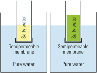

Osmosis may be a less familiar process, but it's equally important. In an osmotic process, water flows from a solution with a lower solute concentration (for example, fresh water) through a semipermeable membrane into a solution with a higher solute concentration (for example, saltwater) until the salt concentrations on both sides of the membrane equalize or until enough pressure builds on the high-concentration side to stop the flow (see box).
