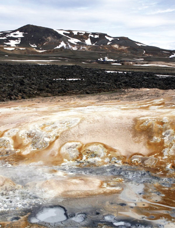

3. A hot prospect. A project that entailed drilling a 6,900-foot-deep geothermal well to test whether geothermal fluids at supercritical pressures and temperatures could be exploited as a source of power in Iceland’s Krafla volcano came to a halt in 2009 after 1,652F magma intruded the open borehole. Researchers terminated drilling and finished the project as a production well—harnessing magma energy. The drilling rig is viewed in this picture across a basalt flow from the 1974-85 eruption. The Leirhnjúkur hot spring area is in the foreground. Courtesy: W. Elders, University of California, Riverside
