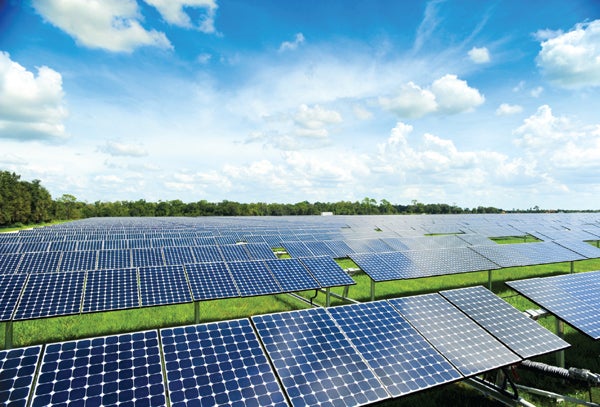

At the DeSoto facility, the PV panels are mounted onto tracking devices that follow the path of the sun throughout the day to maximize energy output (Figure 1). The panels were manufactured by SunPower Corp. Panel output is backed by a 30-year manufacturer guarantee.
1. Carpeted with PV. These are just a few of the 90,000 PV panels that compose the DeSoto Next Generation Solar Energy Center. Courtesy: FPL
