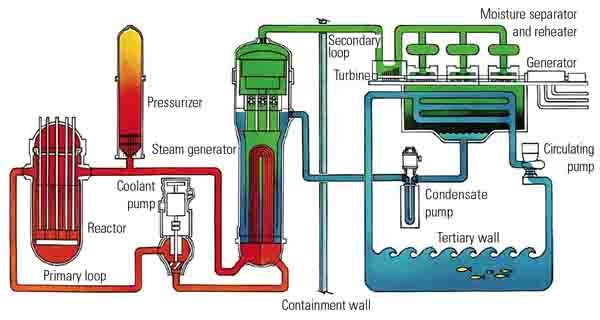

MG sets were originally used to drive the reactor circulating pumps (Figure 1). Their purpose was to control reactor reactivity by changing pump speed and therefore the rate of fluid flow through a boiling water reactor. Today, pumps retrofitted with VFDs permit much more precise speed control and have the potential for achieving speeds (and fluid flow) above the speed set by the line frequency of 60 Hz. An added benefit is the combination of an AC induction motor powered by a VFD, which results in a much more efficient combination than an MG set. The VFD can provide very slow acceleration rates when low-power operation is required. Because raising pump speeds raises reactor power, plants are very cautious about speed control.
1. Three-ring circus. The tertiary loop of the pressurized water reactor uses a circulating pump to condense the turbine exhaust steam. By using a variable-frequency drive to control the circulating pump, significant reductions in auxiliary power are possible, as well much more precise control of the reactor. Source: Siemens LDA
