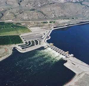

Unlike fossil fuel – powered generating stations, hydroelectric projects consume a noncombustible "fuel" that also happens to be the most common and effective fire suppression agent — water (Figure 1). Our favorite fire suppression agent may be readily available in unlimited quantities, and often already under pressure, but don’t let that fact lull you into believing that hydroelectric stations are "fireproof."
1. One of a kind. An aerial photo shows the Wells hydrocombine dam, owned and operated by PUD #1 of Douglas County, located on the Columbia River in the state of Washington.The first unit began commercial service in 1967. The generating units, spillways, switchyard, and fish passage facilities are combined in a single structure, or hydrocombine. Courtesy: PUD #1 of Douglas County, Wash.

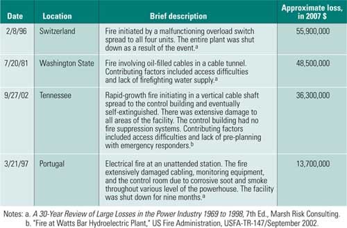

It is true that hydro plants have perhaps the lowest fire risk among electric generating facilities, but that’s only because, generally speaking, the likelihood of a fire is lower than in a fossil-fueled power station. Hydro plants are not without fire risk, and history reminds us that large-loss fires have occurred (see table).
Sample of large-loss fires at hydroelectric generating facilities. Source:Starr Technical Risks Agency Inc.
