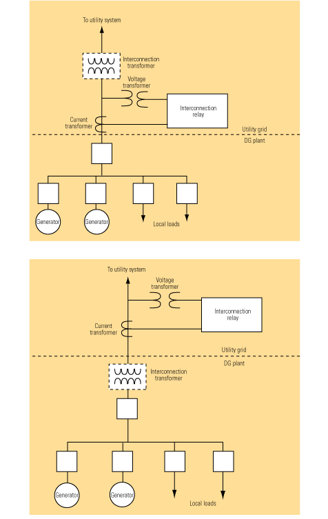

The Standard provides limited specific guidance on damage prevention other than calling for over/underfrequency and over/undervoltage interconnection protection. However, it does specify that the protection be installed at the Point of Common Coupling (PCC) between the DG and the utility system. The installation can be either at the secondary of the interconnection transformer (Figure 1, top) or at its primary (Figure 1, bottom), and the choice will determine who incurs the transformer losses. The circuit to protect the generator itself is typically installed at its terminals.
1. Take a side. Typical interconnection protection applied at the secondary (top) or primary (bottom) of the interconnection transformer. Source: Beckwith Electric Co., Inc.

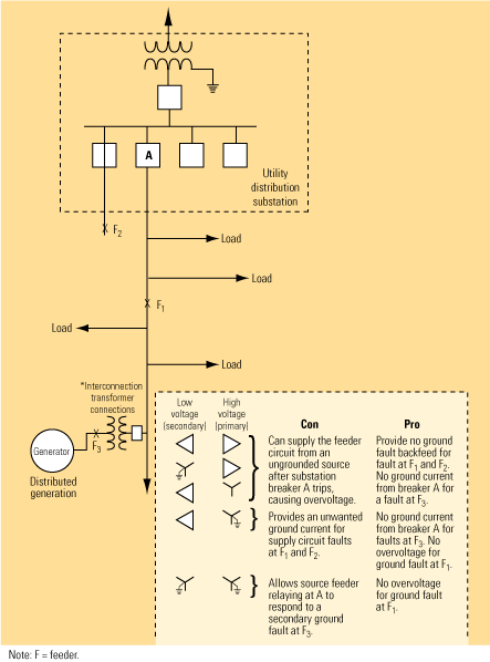

Most DG plants of 10 MW or less are connected to a utility's distribution grid. In the U.S., most distribution systems are multigrounded four-wire designs whose voltage ranges from 4 kV to 34.5 kV. This design allows single-phase, pole-top transformers (which typically constitute the bulk of the feeder load) to be rated at line-to-neutral voltage. Thus, on a 13.8-kV system, single-phase transformers would be rated at 13.8 kV/1.73 = 8 kV. Line-to-neutral-rated transformers and lightning arrestors can be subjected to damaging overvoltages depending on the choice of DG interconnection transformer. Five different kinds of transformer connections are widely used to interconnect dispersed generators to the utility grid (Figure 2, bottom). Each has advantages and disadvantages, as noted.
2. Five easy pieces. Alternatives for connecting interconnection transformers. Source: Beckwith Electric Co., Inc.
