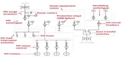

Power systems today operate in an environment where reliability and safety must be maintained despite rising loads, expanding interconnections, and increasing dependence on distributed energy resources. One of the most important technologies that supports this stability is the digital overcurrent relay. Although relays have existed for generations, the modern digital version has reshaped how engineers detect abnormal current conditions and protect equipment across both transmission and distribution networks. These relays apply complex logic, communicate with other intelligent devices, and respond with the precision necessary to isolate faults before they escalate into wider system disturbances.
A digital overcurrent relay constantly measures current and compares it with its programmed pickup values. When current reaches or exceeds a threshold, the relay determines the fault severity and decides whether to issue a trip signal to the circuit breaker. Behind this simple concept lies a layered system of protection principles that distinguishes normal variations from dangerous conditions. Instantaneous overcurrent protection responds immediately to very high fault currents, clearing severe faults before they inflict mechanical or thermal stress on equipment. Time-overcurrent protection, on the other hand, operates with a calculated delay so that devices closest to the fault can act first. This ensures selectivity within the system, allowing only the protective device nearest to the fault to interrupt the circuit while upstream devices remain in service.
This is a one-line diagram of a medium voltage (MV) power distribution system. Source: Sree Lakshmi Vineetha Bitragunta

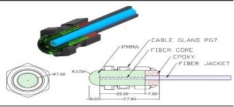

Safety is another area where digital relays provide essential benefits. Arc flash incidents present extreme hazards in electrical systems, and reducing fault clearing times is a primary method of limiting incident energy. Modern relays include arc flash detection inputs that work with optical or fiber-optic sensors to recognize light from an arc and trigger immediate tripping. This approach results in significantly faster clearing times than current-based detection alone. Zone selective interlocking also enhances safety by allowing upstream relays to restrain tripping when a downstream device identifies a fault, preserving selectivity while reducing overall arc flash energy. Digital relays further contribute to safer systems through sensitive earth-fault detection, which identifies ground faults at early stages and prevents overheating, insulation failure, and fire risk.
Arc flash detection scheme using fiber-optic sensors integrated with digital overcurrent relays to achieve ultra-fast fault clearing. Source: Sree Lakshmi Vineetha Bitragunta
