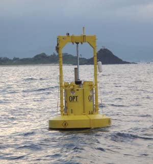

Ocean Power Technologies Inc. (OPT) announced on Feb. 1 that it had successfully deployed one of its PowerBuoy wave energy devices about a mile offshore from a U.S. Marine Corps Base on the island of Oahu in Hawaii (Figure 5). The device generates up to 40 kW of power from the rise and fall of waves, and since its deployment in December 2009, it has been generating power within specifications.
5. Marine waves benefit Marines. Ocean Power Technologies’ PowerBuoy wave energy converter off the coast of Hawaii is providing power to a U.S. Marine Corps base. By design, the PowerBuoy sits primarily below the sea surface when deployed, resulting in minimal visual impact. Courtesy: Ocean Power Technologies Inc.
OCT built and will operate the device as part of a program with the U.S. Navy, which is testing OPT’s wave power technology. (To comply with Executive Order 13423, federal agencies must ensure that at least half of all renewable energy required under the Energy Policy Act of 2005 comes from new renewable sources developed after January 1, 1999.) The company has been awarded $380,000 for the PowerBuoy’s commissioning and in-ocean operation.
