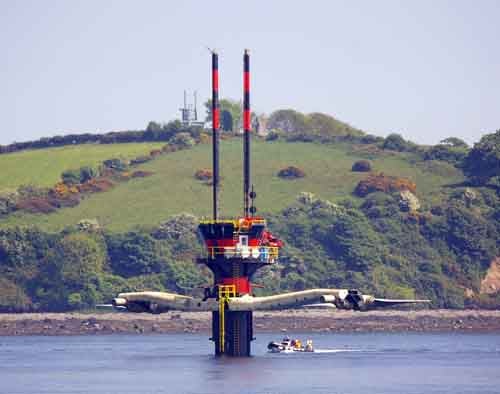

In November, Marine Current Turbines (MCT) claimed that the 1.2-MW SeaGen—the world’s first commercial-scale tidal stream device—was in line to produce 7,000 MWh of marine energy per year, far exceeding original predictions of 5,000 MWh. MCT cofounder Peter Fraenkel said that the turbine installed in Strangford Lough in Northern Ireland was running in an extremely aggressive environment (see photo). “It should be remembered it is being driven by a wall of water 27 m deep, similar to the height of the Tower of London, that surges back and forth with every tide through the Strangford Narrows … at speeds of up to 10 miles per hour. We are getting more energy than expected mainly because the resource is more energetic than originally predicted during earlier surveys.”
A power surge. The 1.2-MW SeaGen—the world’s first commercial-scale tidal stream device—produces 7,000 MWh of marine energy per year, exceeding predictions of 5,000 MWh. The increase was due to the “aggressive” conditions in Strangford Laugh, a shallow inlet in Northern Ireland where tides gush in at speeds of up to 9 mph. The 37-meter-long device with 16-meter-diameter twin rotors was installed in April 2008. Courtesy: Marine Current Turbines

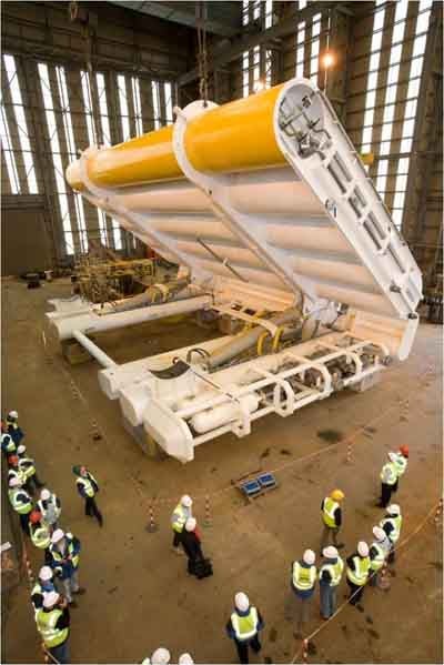

In contrast to many other wave power devices, Oyster uses hydraulic technology to transfer wave power to shore, where it is then converted into electricity. “A key design feature is a 18-m-wide oscillator based on fundamental research at Queen’s University Belfast led by Professor Trevor Whittaker using their wave tanks,” explained Dr. Ronan Doherty, Aquamarine’s chief technical officer. The oscillator is fitted with pistons and, when activated by wave action, pumps high-pressure water through a subsea pipeline to the shore. Onshore, conventional hydroelectric generators then convert this high-pressure water into electrical energy (see photo).
The world and one Oyster. Funding by the UK government to speed up marine energy prototype development through to early-stage commercial generation could spur demonstrations of innovative technologies like Edinburgh-based Aquamarine Power’s giant “Oyster.” Designed to be deployed at near-shore water depths of 12 m to 16 m, the device uses hydraulic technology to transfer wave power to shore. The 18-m-wide oscillator is fitted with pistons, which are activated by wave action and then pump high-pressure water through a subsea pipeline to shore. Conventional hydroelectric generators then convert the water energy to power. Courtesy: Aquamarine Power
Oyster is designed to be deployed at near-shore water depths of 12 m to 16 m to benefit from more consistent seas and narrower directional spread of the waves. The reduced wave height and load enhance survivability and allow a high percentage of annual average power and consistent power delivery. Any excess energy is spilled over the top of the flap, its rotational capacity, allowing it to literally duck under the waves.
