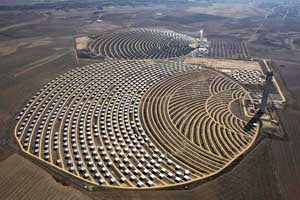

Yet, Abengoa, like several entities around the world, deems the technology "feasible and reliable." Despite the economic crunch, and egged on by climate change concerns, it has developed and plans to inaugurate in the coming months a second-generation plant, the PS20, on land adjacent to the PS10. Like PS10, the PS20 will use water as the operating fluid, delivering 55 MWt of saturated steam at 250C (500F) to turn an electricity-generating turbine. But it will be much larger: Using 1,255 heliostats, PS20 is expected to produce up to 20 MW of power (Figure 2).
2.    Sunscrapers. Spain’s Abengoa Solar is wrapping up construction of a second-generation solar tower, the PS20, at its Solucar Solar Park at Sanlúcar la Mayor, just outside Seville. At double the capacity of the existing 11-MW PS10 plant at the same site, which Abengoa says is the world’s first commercial solar tower plant, the new plant will consist of 1,255 heliostats and a 160-meter/525-foot-tall tower. The company also plans to build a third tower, the AZ20, which will improve on the technologies used in PS10 and PS20. By 2013, the site is also expected to house three solar trough plants, each 50 MW, and an experimental concentrated solar power plant based on Sterling dish technology. Courtesy: Abengoa Solar

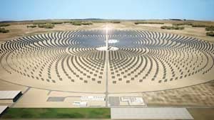

Spanish company SENER, meanwhile, is building a 17-MW facility, with a mirror field measuring 298,000 square meters (3.2 million ft2), also in Andalusia (Figure 3). That plant, Gemasolar (previously known as "Solar Tres"), has been under development for seven years now at the hands of SENER and, more recently, Abu Dhabi firm Masdar. It should be operational by 2011. Unlike PS10, it will use molten salt heated to 565C (1,049F) to transfer heat.
3.    Worth its salt. SENER and Abu Dhabi firm Masdar are building the 17-MW Gemasolar (previously “Solar Tres”) facility in Fuentes de Andalucía, in the province of Seville. That plant, slated for completion by 2011, will use molten salt technology developed at the U.S. Department of Energy’s Mojave Desert Solar One and Solar Two projects. The companies say Gemasolar will be the “world’s first utility-grade solar power plant with central tower and salt receiver technology.” Courtesy: Torresol Energy
Molten salt technology was developed from U.S. Department of Energy pilot tests in the 1990s of the Solar One and Solar Two projects in the Mojave Desert. This method will give the Spanish plant a thermal storage advantage of 647 MWh (permitting 15 hours of turbine load) over PS10’s paltry 20 MWh with steam (or 30 minutes), according to the Fraunhofer Institute for Systems and Innovation Research. But that advantage will have a cost, the group said: Gemasolar’s total efficiency is 14% — worse than PS10’s 15.45%. Added to that, due in large part to the associated storage technology, Gemasolar’s generation costs will be €78.5 /MWh ($105.3/MWh) higher than that of PS10.
