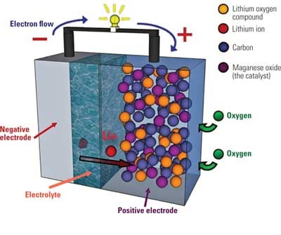

The STAIR (St. Andrews Air) cell capacity is based on rechargeable lithium batteries, which are currently composed of a graphite negative electrode, an organic electrolyte, and lithium cobalt oxide as the positive electrode. Instead of lithium from the layered intercalation compound (lithium cobalt oxide), the STAIR uses a porous carbon electrode. The oxygen, which will be drawn in through a surface of the battery exposed to air, reacts within the pores of the carbon to discharge the battery. The university has discovered in the course of its four-year study that the carbon component’s interaction with air can be repeated, creating a cycle of charge and discharge (Figure 6).
6.    Air-fueled battery. Researchers from the University of St. Andrews in the UK have designed an air-fueled battery that they claim could last 10 times longer than designs currently available. As the diagram of the lithium-air STAIR (St. Andrews Air) cell shows here, oxygen is drawn from the air and reacts within the porous carbon to release the electrical charge. Courtesy: University of St. Andrews
