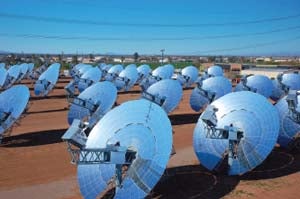

The Maricopa Solar power plant (Figure 6) is the first commercial project for the SunCatcher CSP technology designed and manufactured by SES. The facility uses 60 SunCatcher Stirling dishes. Each 25-kW SunCatcher consists of a 38-foot mirrored parabolic dish combined with an automatic tracking system to collect and focus the sun’s energy onto a Stirling engine to convert the solar thermal energy into electricity.
6. Focused energy. The 1.5-MW Maricopa Solar power plant is the first to use Stirling Energy Systems’ Stirling dish technology, which will be deployed at 1,500-MW plants in California and Texas. Courtesy: Stirling Energy Systems
