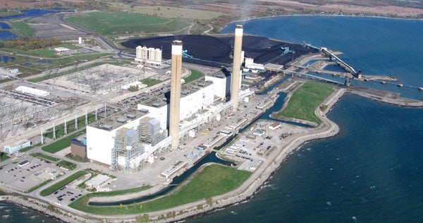

The federal government’s announcement follows a pledge by the province of Ontario to close all four of its remaining coal-fired thermal stations—Atikokan, Lambton, Nanticoke, and Thunder Bay—by Dec. 31, 2014. Nanticoke (Figure 5) has repeatedly been scheduled for closure by Ontario Power Generation (OPG). The plant was originally scheduled to be closed in 2009, but that plan was dropped in 2006 when OPG was unable to develop replacement power sources. Nanticoke is exploring converting the plant to combust biomass (see “OPG Charts Move from Coal to Biomass,” POWER, April 2010).
5. Familiarity breeds contempt. The 3,640-MW Nanticoke Generating Station on the north shore of Lake Erie, Ontario, is the largest coal-fired power plant in North America. Since its completion in 1978, at a cost of nearly C$800 million, more than C$900 million has been spent on energy efficiency, reliability, and environmental improvements at the plant’s eight units. The plant is now scheduled to phase out its use of coal by 2014, and switch to biomass, as part of a larger measure by the provincial government. Canada’s federal government recently said it would phase out all the country’s older coal plants, a measure that could affect 33 of the nation’s 51 coal-fired facilities. Courtesy: Ontario Power Generation
