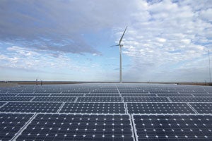

New Jersey's gaming mecca is hosting one of the largest hybrid (solar-wind) power plants in the world (Figure 3). The Jersey-Atlantic Wind Farm, with 7.5 MW of wind capacity and 0.5 MW from photovoltaic (PV) cells, is expected to generate 20,000 MWh annually. That should be enough to power an adjacent wastewater treatment plant operated by Atlantic County Utilities Authority (ACUA) and 2,500 homes as well. ACUA dedicated the facility in December, and it is nearly finished. To track the final stages of the project, visit www.njwind.com/webcam.html.
Courtesy: Alternity Power
3. Doubly renewable. Atlantic City, N.J., is now home to one of the world's largest (8-MW) wind-photovoltaic power plants. It is one of the few coastal wind farms anywhere.
