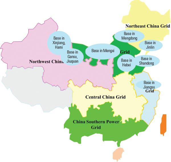

During the 12th Five-Year period, the eight biggest wind power bases will gradually be constructed in Hebei, west Inner Mongolia, east Inner Mongolia, Jilin, Shandong, Jiangsu, Jiuquan, and Hami. The installed capacity of each base may exceed 10 GW, and total capacity could reach 65 GW. Bases in Jiangsu and Shandong will mainly focus on offshore wind power development. The distribution of wind resources in China is shown in Figure 2; distribution of the eight largest wind power bases is shown in Figure 3.

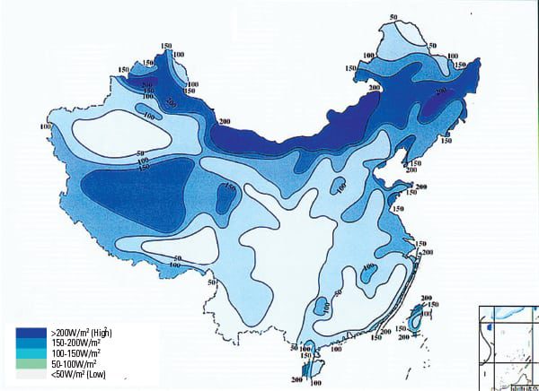

PWR_120113_China_Renewables_fig2
2. Wind density map of China. Courtesy: Zeng Ming, Xue Song, Ma Mingjuan, Zhu Xiaoli. “New energy bases and sustainable development in China: A review.” Renewable & Sustainable Energy Reviews, 2013, 17:169–185
PWR_120113_China_Renewables_fig3
3. Distribution of the eight planned large wind power bases. Courtesy: Zeng Ming, Xue Song, Ma Mingjuan, Zhu Xiaoli. “New energy bases and sustainable development in China: A review.” Renewable & Sustainable Energy Reviews, 2013, 17:169–185

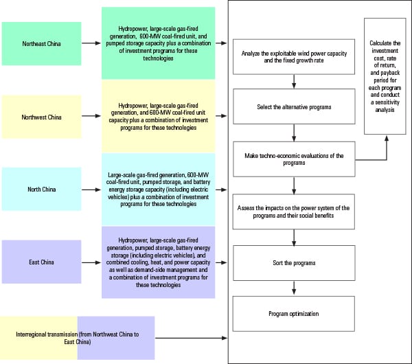

A flow chart of the techno-economic evaluation of technologies supporting VG integration in China is shown in Figure 4.
PWR_120113_China_Renewables_fig4
4. The plan at a glance. This flow chart shows the proposed stages of a techno-economic evaluation of technologies that could be used to support the integration of large-scale variable renewable energy (predominantly wind power) in China. Source: Zeng Ming, Li Shulei, Xue Song

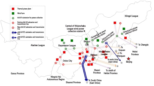

PWR_120113_China_Renewables_fig5
5. Transfer of power plan. This map of the regions with the greatest wind power potential shows recommended substation and transmission line placement for optimizing the transfer of variable power to higher-demand regions. Source: Bo Zeng, Ming Zeng, Xue Song, Min Cheng, et al. “Overall review of wind power development in Inner Mongolia: Status quo, barriers and solutions,” Renewable & Sustainable Energy Reviews, 2013, 29: 614-624
In considering this challenge, we will propose an interregional transmission plan considering relevant issues to improve VG consumption levels and increase energy utilization efficiency. We will also take the ultra-high-voltage transmission line from Northwest China to East China as an example to evaluate possible economic and environmental benefits.
