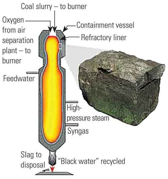

The NETL-developed material, "AUREX95P" (Figure 4) represents the "most significant improvement in gasifier refractories in over 25 years," and it could eliminate roadblocks that limit the use of gasification technology for electric power and other product production, the federal laboratory said last November.
4. A silver lining. The National Energy Technology Laboratory has developed a phosphate- modified high-chrome oxide material that increases the service life of components (refractories) used to line the interior of slagging gasifiers, when compared with conventional liner materials. The NETL refractory has approximately 50% more material remaining after the test. Source: NETL
