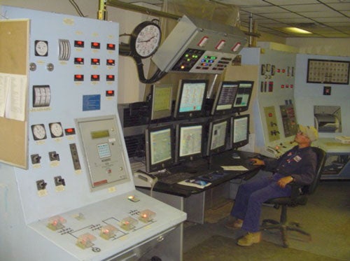

Before commissioning the new I/A Series system, American Ref-Fuel trained its operators on it and physically prepared the plant to avoid any unnecessary downtime. The new control system's workstations, controllers, and networking were installed alongside those of the Westinghouse WDPF while it was still on the job. On the day of the switchover, the process was shut down and the new I/O modules were swapped in (Figure 8).
8. Quick-change artist. It took just 18 hours for American Ref-Fuel to retrofit its waste-to-energy plant in Massachusetts with a new distributed control system.Courtesy: Invensys Process Systems
"The modules went in very quickly," said Haselbauer. "It took only 2 hours to install the I/O modules in each cabinet. We spent the rest of the 'down day' testing the new system to make sure all of our process readings were correct. From beginning to end, the plant was down for only 18 hours."
