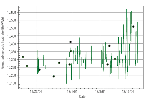

In December 2004, routine reviews of daily performance reports for one of the Ameren units revealed that actual turbine-cycle heat rate (TCHR) was significantly higher than expected values at loads above 350 MW. To discount the effect of unit loading, TCHR and net unit heat rate (NUHR) were trended for four weeks. The results then were filtered to reflect only those periods when the unit was operating at full load and under steady-state conditions (Figure 5).
  5. Trend-spotting. Net unit heat rate (actual) at full load (595 MW) and at steady-state operation.
Courtesy: General Physics Corp.
Because the degradation in heat-rate performance occurred over a relatively short period of time, leaking cycle isolation valves were the obvious suspects. Plant support personnel were asked to develop a high-level cycle isolation program for the affected unit. They began by retrieving the unit's turbine-cycle piping and instrumentation drawings and identifying and highlighting the key valves on them.

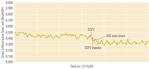

The first two valves were the air-operated steam seal feed valve (SSFV) and the seal feed valve bypass. Upon further inspection, the survey team found the SSFV partially open, so operators closed it completely from the control room. The result of this action was an observed decrease (improvement) in gross turbine-cycle heat rate of about 30 Btu/kWh.
The steam seal feed valve bypass also was found to be partially open. At the request of the survey coordinator, operations personnel completely closed it, too, again producing an observed decrease in gross turbine-cycle heat rate—in this case, 20 Btu/kWh.
The third leaking valve was a motor-operated automatic drain valve (called the main stop, or MS, auto-drain valve) below the seat drain. This valve is open during unit start-up and closed during normal operation. It was found to be one full turn off of its seat, allowing main steam to bypass the turbine and flow to the condenser. After this valve was completely on December 17, 2004, gross turbine-cycle heat rate was observed to decrease by about 70 Btu/kWh (Figure 6).
  6. Recovered revenue. The effect of fully closing three leaking valves on gross turbine-cycle heat rate.

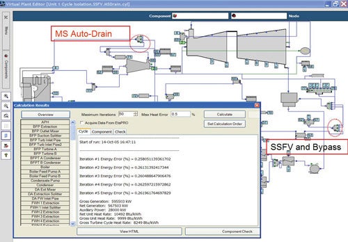

Plant personnel used another tool to validate the data collected during the survey: General Physics' Virtual Plant, a first-principles, integrated boiler and turbine-cycle model. During the survey, engineers modified the thermodynamic model of the unit to account for the leakage from the three partially open valves (Figure 7).
  7. Hurting heat rate. The Virtual Plant model was modified to take into account the leakage from SSFV, SSFV Bypass, and MS Auto-Drain.
When the MS auto-drain valve was closed, the model reflected a 77 Btu/kWh decrease in TCHR, which correlates well with the 70 Btu/kWh decrease observed by EtaPRO. Similarly, when the gland steam sealing system valves were closed, the model reflected a 41 Btu/kWh decrease in TCHR, which correlates well with the observed 50 Btu/kWh decrease.
The cumulative effect of the three leaking valves was an increase of 120 Btu/kWh in gross turbine-cycle heat rate, which corresponded to an increase of 150 Btu/kWh in unit heat rate. Ameren estimated that this increase raised the unit's annual fuel cost by $760,000 and resulted in lost generation of 24,500 MWh.
