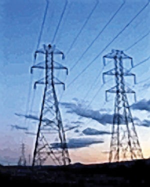

1. Lesser of two evils. The costs to comply with new, mandatory FERC cyber security standards are insignificant compared with those of an outage as widespread as the August 2003 Northeast blackout. Courtesy: NREL

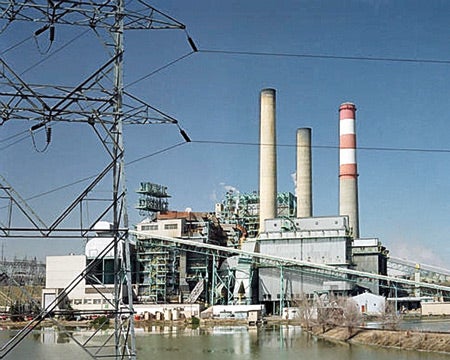

2. Change in the air. Many responsible entities are unsure how to identify their critical cyber assets and are understandably loath to allow others to do so. Courtesy: NREL
