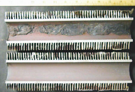

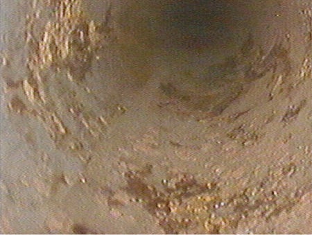

The following series of incidents occurred over several months at a new 3 x 1 combined-cycle cogeneration plant in a southern state. After its initial start-up, the plant routinely performed wet chemistry tests but did not maintain its sample panels. Several water chemistry upsets occurred during the first several months of operation, including both low- and high-pH events. Data from the plant’s new on-line analyzers (which operators didn’t trust) clearly showed all of both kinds of events, but many of them were not detected by the wet tests. None of the sample panel analyzers was alarmed to the plant’s DCS.
The root cause of the events, which were relatively short in duration, was diagnosed as instrument condensate contamination. Operators got into the lazy habit of feeding caustic when drum pH was low and securing chemical feed and blowing down when the pH was high. They had several opportunities to use the new on-line analyzers to detect problems, but because the instruments were poorly maintained and untrusted, their readings were disregarded. The lack of functional alarms contributed to the lack of situational awareness—only two of the six on-line pH analyzers were in service.
The six pH analyzers monitored the high-pressure (HP) and intermediate-pressure (IP) drums of the plant’s three heat-recovery steam generators (HRSGs). The two operating analyzers clearly showed severe pH depressions or elevations as host condensate quality varied. Because the plant was relying only on wet test data, operators neither saw these excursions nor appreciated their significance.
As you’d expect, the tubes of this plant’s HRSGs began to overheat and fail after only six months of operation. But the tube failures were only the first signs of a serious water chemistry problem. Another was the formation of iron deposits in the lower bends of the tubes (Figure 1), detected by an initial inspection. This particular plant is especially vulnerable to iron deposition because it uses high levels of duct firing on its HRSGs, which increases the heat flux across their tubes. Subsequent inspections also showed significant material loss throughout the tubes (Figure 2), not just at bends.
1. Ironed out. Iron deposition in HRSG tubes reduces the tubes’ life expectancy as well as unit generating capacity. Courtesy: Nalco
2. Going deep. Abnormal loss of material from an HRSG tube, detected by a boroscope inspection. Courtesy: Nalco
Because four on-line analyzers were out of service and the other two were not trusted by the operators, the plant addressed the problem’s symptoms, rather than its root cause. It did so by chemically cleaning the HRSG tube sections that had remained unaffected and replacing those with holes or heavy deposits.
Those repairs cost millions of dollars, and during the outages needed to make repairs, the plant lost millions more in production revenue. Equipment life was considerably shortened because the analyzers didn’t perform due to slack O&M training and procedures plus poor alarm management—not because “those new analyzers didn’t work.”
