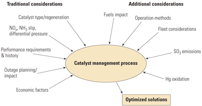

Catalyst management refers to a comprehensive methodology for predicting when catalyst layers should be replaced or regenerated, or a new layer added, based on catalyst deactivation rates, performance requirements, and system capabilities. Effective catalyst management requires a long-term plan for maximizing performance based on projected plant outage schedules, future emissions regulations, available control technologies, and plant improvements. Catalyst management strategies require the evaluation of numerous issues—boiler/SCR system operations, the plant's and fleet's emissions-reduction strategy, fuel management, the cost of NOx credits, outage demands, SO3 emissions levels, mercury oxidation, capital budget considerations, and more—with the goal of achieving an optimal solution (Figure 1).
 Source: Cormetech Inc.
1. Many considerations. An optimized catalyst management process takes into account more variables than you might expect.

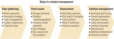

The process can be broken down into specific steps, facilitating its management by the plant owner/operator (Figure 2). Each step must be considered and planned for before determining an optimal solution for the site-specific situation.
2. Steps in catalyst management. Catalyst management involves optimizing a wide range of parameters.
