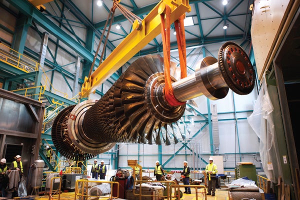

The next-generation GT24 is capable of delivering 230 MW at 40% efficiency (with a heat rate of 8,571 Btu/kWh), the company claims. The KA24 combined cycle plant can achieve 700 MW output in a 2 x 1 configuration, and when fully optimized, it achieves more than 60% gross efficiency. The plant also features a spinning reserve for delivering more than an additional 450 MW in 10 minutes in low-load to baseload settings. The full upgrade package has been implemented in the grid-connected GT26 Test Power Plant in Birr, Switzerland (Figure 1). Alstom plans to manufacture key plant components of the upgraded gas turbine at its factory in Chattanooga, Tenn.
1. A notch above. Alstom in September launched an upgraded GT24 gas turbine and corresponding KA24 combined cycle power plant for 60 Hz electricity markets. The turbine was tested at Alstom’s grid-connected GT26 Test Power Plant in Birr, Switzerland. Courtesy: Alstom
