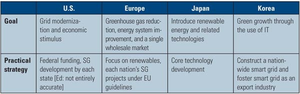

One illustration of this can be seen in two sets of slides from presenters at GridWeek 2009, held last September in Washington, D.C. Table 1 consolidates the Korean view of the global smart grid picture presented at that event.
1.    One view of the different national and regional smart grid goals and strategies. Source: GridWeek 2009

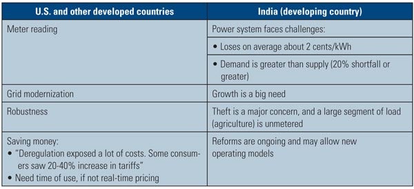

Another way of thinking about the differences came from a presentation by Dr. Rahul Tongia, who has affiliations with a Bangalore, India think tank and Carnegie Mellon University in Pittsburgh. Table 2 summarizes his view of the drivers for smart metering and smart grids in developed and developing nations.
2.    Reasons for developing a smart grid differ. Source: GridWeek 2009

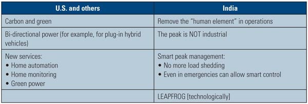

Tongia’s view of “Future (or even Subtle) Drivers” makes the contrasts even clearer, as summarized in Table 3.
3. Future (or even subtle) drivers of smart grid technologies. Source: GridWeek 2009
