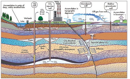

1. Drilling to store gas. Properly sited, engineered, and managed geological reservoirs can be expected to retain stored CO2 for hundreds to thousands of years. However, there are many legal issues remaining for developers of sequestration facilities. Source: EPRI
To give you an idea of the volumes we’re talking about, a large coal-fired plant discharges 6 million tons of CO2 annually. According to one estimate given at the meeting, the total from 800 coal plants would be twice the volume of oil transported in the U.S. For this reason, one speaker—Bill Martin of Atlantic Energy Ventures LLC—said we need a “CO2 superhighway” to service many plants. Imagining the necessary infrastructure boggles the mind.

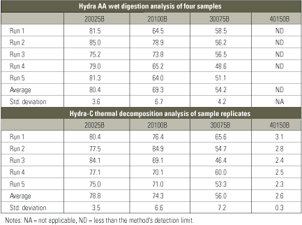

Thermal decomposition
A Hydra-C direct mercury analyzer, also from Teledyne Leeman Labs, is suitable for running the thermal decomposition analysis and comparing its results to those of the wet digestion method. The instrument and its schematic are shown in Figures 4 and 5, respectively; Table 2 lists its key operational parameters. A feature of the Hydra-C that is important to users at coal-fired plants is its ability to measure the level of mercury in sorbent traps, as specified by CFR 40, part 75, Appendix K.
Table 3. Summarizing the results of the two measurement methods. Source: Teledyne Leeman Labs
Despite the fundamental differences between the wet digestion and the thermal decomposition approaches to mercury analysis, the two techniques show excellent correlation. The comparative results presented here showed no analytical bias and were well within the techniques’ confidence limits.
