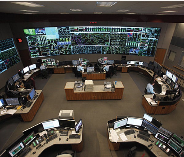

Essentially, the AC2program reduces risk because “the two fully staffed primary control centers better ensure uninterrupted operation of markets and grid control if functionality were lost at either center,” PJM said (Figure 5). The scalable, service-oriented architecture (SOA) for large energy management/market management systems promotes interoperability that “cannot be found in proprietary, legacy systems,” it said. The SOA-based system provides a common approach for software applications and computer-based infrastructure to exchange data and information. It also allows technology from other vendors to communicate and interoperate without special adaptation.
5. Two ways about it. PJM completed a $200 million program that essentially replaces an aging centrally dispatched legacy system with two state-of-the-art primary control centers. Courtesy: PJM
