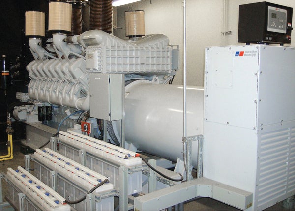

As in most mission-critical facilities, the Synovus data center uses layers of redundancies to prevent loss of services or data. Starting at the server cabinets, Whipkey explains, every cabinet has two power supplies. These, in turn, are backed up by dual utility feeds and uninterruptible power supply (UPS) systems. The last line of defense is the emergency standby power system, consisting of two 2,250-kW MTU Onsite Energy diesel generator sets that operate independently (Figure 4).
4. Eight-second ride. Two MTU Onsite Energy 2,250-kW generator sets back up the main data center for Synovus Financial. The generator sets can start and assume full load in less than 8 seconds in the event of a major power disruption. Courtesy: MTU Onsite Energy
“We have a fairly unique backup system at Synovus. The critical power system is a redundant configuration using static UPS systems with flywheels instead of chemical batteries. We wanted to get away from a battery-backed UPS system because of ecological concerns regarding acid containment. There also are maintenance issues with wet cells that we wanted to avoid,” said Whipkey. “The flywheels give us about 25 seconds of full load facility power after a utility outage, so we needed emergency standby generators that could start and accept load in 8 seconds or less. One of the reasons we chose MTU Onsite Energy was because these generators can start and assume full load in just 7.5 seconds.”
