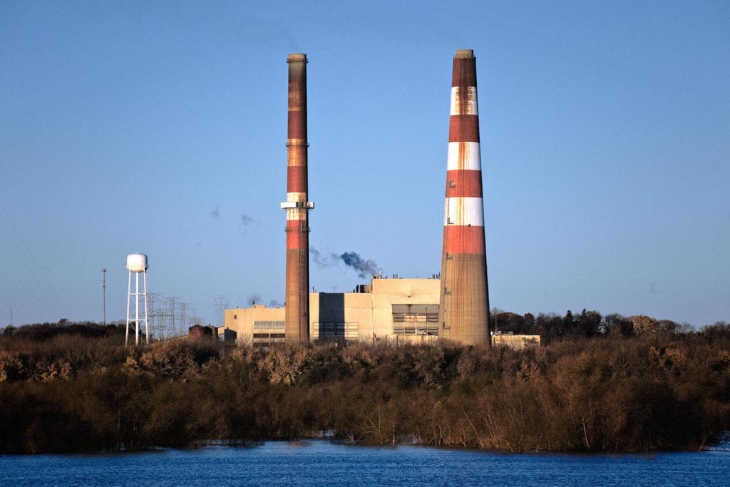

The company on Aug. 21 said it will close the 54-year-old 915-MW Coffeen Power Plant; the 43-year-old 425-MW Duck Creek Power Plant; the 41-year-old 434-MW Havana Power Plant; and the 66-year-old 294-MW Hennepin Power Plant. All the plants are in downstate Illinois. Four other coal plants acquired through its merger with Dynegy in April last year that are regulated under the MPS will keep operating.
