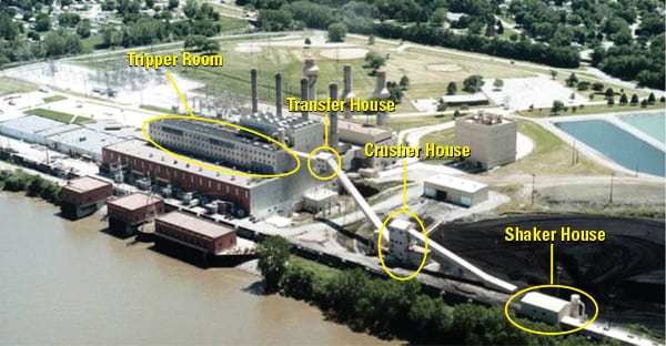

The North Omaha Station consists of five units with a combined capacity of 625 MW and is part of the 3,200-MW OPPD system. The last unit entered commercial operation in 1968, 14 years after the first unit was constructed. NOS was originally designed to combust Midwestern high-sulfur coal. In 1985, the attractive environmental advantages and cost-effectiveness of PRB coal resulted in the decision to transition the station to the low-sulfur coal. The lower heat content and higher ash content of the subbituminous coal meant that the coal burn rate would have to increase in order to deliver the same fuel energy content compared to bituminous coal, although the plant was not derated as has occurred at other plants. In addition, the entire fuel system—from unloading on the coal pile through the burner tip—required upgrades in equipment, plant operating processes, and additional training of the plant staff. Safe combustion of PRB coal is an intentional process. The 105-person staff of NOS joined in the common goal to become a leader in safe handling and combustion of PRB coal (Figure 2).
PWR_010114_PRBCUG_Fig2
2. Making the switch. OPPD’s North Omaha Station is composed of five units producing a total of 625 MW. The fifth unit was installed in 1968, the first unit 14 years earlier. The plant made the switch to PRB coal in 1985 and finished a complete upgrade of the plant’s fuel-handling systems in 2012. Courtesy: OPPD

After a series of discussions, OPPD developed a four-phase material-handling improvement program. The first equipment upgrade phase began in October 2009, and all four phases were completed in 2012. Specifically, the material handling upgrade program included equipment changes and upgrades in the Shaker House, where the coal is unloaded from rail cars; the Crusher House, which receives and processes the coal received from the Shaker House; the Transfer House; the Tripper Room, which feeds the coal to the individual boiler fuel silos; and all the conveyors that interconnect the plant (Figure 3).
PWR_010114_PRBCUG_Fig3
3. Comprehensive upgrades. North Omaha Station completed a multi-year upgrade of its coal-handling system in 2012, from the point fuel arrives at the plant through the coal bunkers on each boiler. Courtesy: OPPD

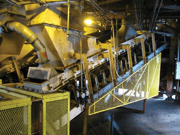

The Crusher House and the Shaker House were originally designed with last-generation dust collection systems, each of which included a collector, blower, disposal system, and long lengths of ducting and many high-maintenance isolation valves. Both dust collection systems were removed from service as part of the project, thus eliminating a potential explosion hazard. In their place, Martin Engineering installed insertable dust filter systems in 12 high-dust zones. Instead of conveying dust-laden air to a central dust collector, the insertable system filters the air at the transfer point so the dust can be immediately returned to the conveying system. The dust is captured on a pleated fiber filter that is periodically cleaned using compressed air injected against the reverse side of the filter. Each filter system has two filter elements so that one filter remains in service during the staggered cleaning cycles. Unlike standard filter elements, the filter material is impregnated with carbon fibers so that a buildup of static electricity is not possible (Figure 4).
PWR_010114_PRBCUG_Fig4aPWR_010114_PRBCUG_Fig4b
4. Efficient dust collection. The problematic centralized dust collection systems were retired and replaced by individual insertable dust filter systems at the point of collection. The self-cleaning system returns the collected dust directly back into the enclosed conveying systems. The top photo shows the original dust collection tap placed just above the conveyor. The new insertable dust collection system is shown on the bottom. Courtesy: OPPD
